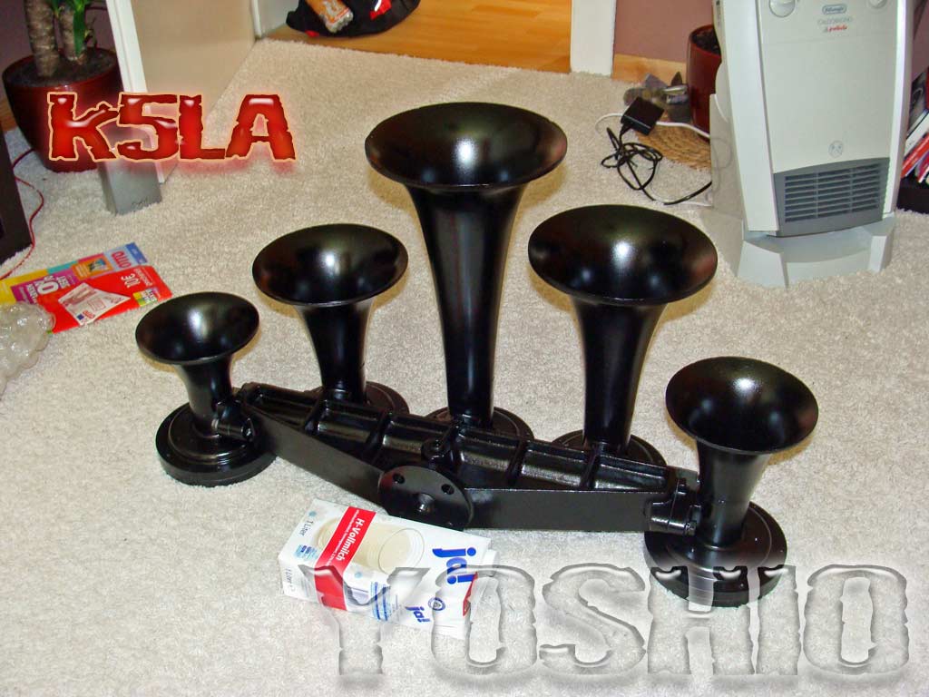

Hier is another mod that is upcomming - see th horn on top of the car ? Thats my new mind blowing train horn.

Here is a closer view of it with a milk pack for reference of size.
This thing is made of 14kg of aluminium and can be loud as 156db @ 150psi pressure. I still cant imagine how would this thing will be - i still dont test the horns, because i´m scared to blow my head off.

Wow that is quite a set of horns!
Where are you going to put them?
And where the compressor?
I saw some clips on youtube of cars with trainhorns.
Ofcourse it is different in real than behind de computer but still.
It will be really really loud.

I´m going to use a diving bottle as reservoir. This bottle got ~10l volumen and 200bar of pre-pressure. Due to the horn, i only need 12bar, so i need a pressure reducer of courese.
I think the horn will take areound 150-200l/min. There for i can go around 10minutes or something.
